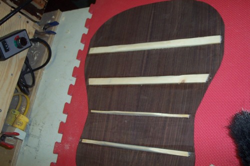

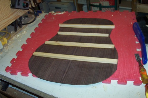

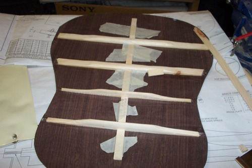

Ok , i'm back, now to the back braces

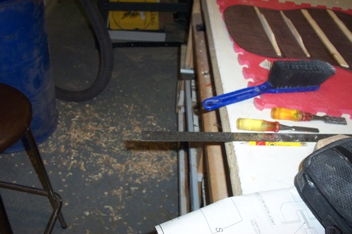

some more shavings, that is my favorite part of the build, right after bending the sides!
to cover the center seam i took some of the top cut out

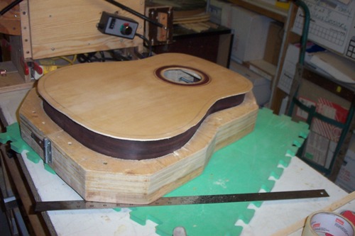

i was curious of what my guitar would look like when the box will be closed so i pretended it was... for a second!

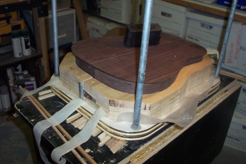

sanded the back of the rim to receive the back plates

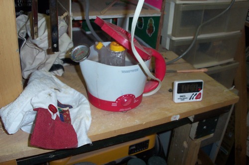

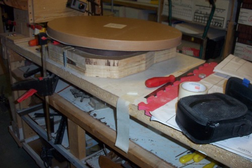

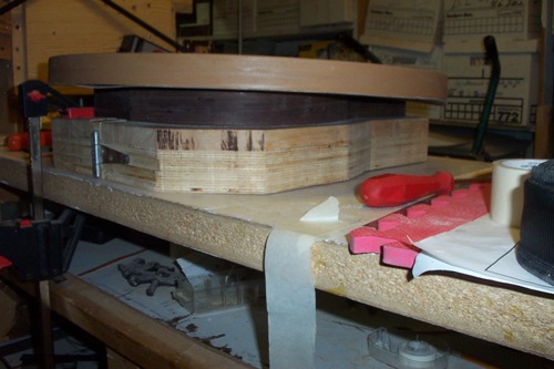

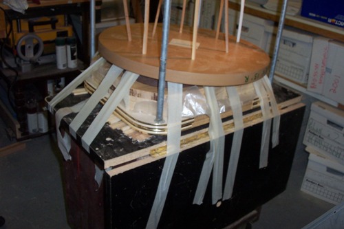

prepared some HHG but had some alignment and humidity problems and had to resort to Titebond for the glue up of the back, i was also too nervous to reuse HHG after cleaning it up the first time. So i used titebond, taped the top to the go bar deck table, put the radius dish on top for weight, some go bars i had pre-cut and the waiting begins...
Now i'm anxious to go down to the shop tomorrow morning and see the result, i'll keep you all posted
